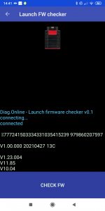

My FW check.
  • Screenshot_2021-06-14-14-41-48-288_top.diagonline.Launch_firmware_checker.jpg
