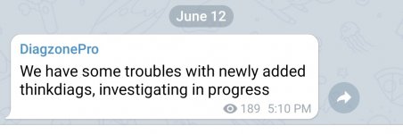

Diagzone pro:
We have some troubles with newly added thinkdiags, investigating in progress

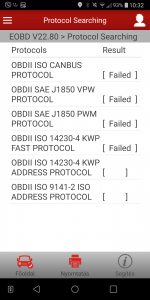

For me EOBD not works now with newly registered thindkiags.
All protocol failed. Checked on two of my cars. Before, with firmware updated thimkdiags this two cars always worked with EOBD via the CANBUS protocol. Now not work.
If i do activate thinkdiag, do you think the BRANDS will work ?
So now only EOBD not work without the vci firmware update, but the real brands will work you say ?
Anyway i think your TATA car in your video should work via the first protocol CANBUS, not the fourth the KWP FAST protocol, don't you think?
