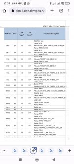

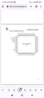

Hi. You need find datashit for gd32f403 and look points for connection on the board.When trying to download eobd at diagzone app, it gives "make your device working as pro you need upgrade microcode" error. But i could not find any soldering scheme of this board. Seller told me that this has old boot.

hi, yes we can flash thinkdiag mini (3 led version) with diagsona's boot , but bluetooth module will be not connecting with app diagzone.Hi. You need find datashit for gd32f403 and look points for connection on the board.
Gnd point can take on obd connector,
+3.3 v can look on any capacitor.
But Thinkcar Pro/ Mucar BT use GD32F407 and use boot different as another deviceHi. You need find datashit for gd32f403 and look points for connection on the board.
