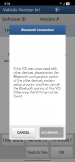

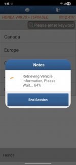

Hi try doit this, downgrade DZ to .013 , and downgrade TPMS program to 10.32 i think 10.36 is made for update in Thinkdiag and hawe some change in location buttons ,in ford i see differences betwen this program , buttons are in diferent places and in older scan ok but i lastes scan with wrong sensors . DZ .019 dont work in obdll comunication dont dialog with car and its not posibile read and write this ID in car module. In my case work only DZ.013 and TPMS10.32 newest DZ and newest TPMS dont work thogether.
Tyr use DZ.013 and TPMS10.32.
Спасибо, попробую. У меня все работало на последней версии и неожиданно перестала работать.
Probably problem is , in changed labels in butons matrix , it a lot different this betwen TPMS10.32 and TPMS10.36, and lastes program scan sensors, with wrong selected type, and dont work if is selected corect type. 10.32 scan corectly but obdll conection with car work in .013 and dont work in .019. Maby this diference has , use different tpms gun , i use thinkdiag vci and thinkcar tpms gun G2. In thinkdiag+, orginal app, gun work , i can not test vci because is flashed to pro for DZ , but is no problem scan sensors in orginall app from thinkcar.
