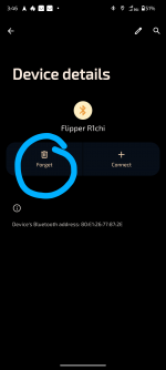

Completely Unpair i-tpms from your BT devices from your phone or tablet. Than pair it thru diagzone app.. like in the picture
