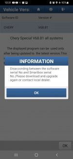

hello,
When i use apk online software works, but when i am offline always show disaccording between software and serial number.
I tried 2 devices.
Anyone have same problem?
HI BUT II SHOULD WORK WITHOUT INTERENT WHAT IS THE PROBLEM,IAM ALSO FACING THIS EVEN WHEN IAM ONLINE ALSO I GET THIS MESSAGE disaccording between software and serial numberIt is new feature - online license.
Will work online if you buy subscription
Did you buy a subscription through a dealer or what? To the one from whom they bought were treated with a problem?disaccording between software and serial number
serial no?I have the same problem with interfase mucar , this was actived full brand
Now All scanners not working offlineserial no?
979860271622serial no?
perfect work offline on my sideNow All scanners not working offline
Cause you use old shell versionperfect work offline on my side
Of course not, I use new (v2)Cause you use old shell version
Hola, tengo el mismo problema, solo trabaja en línea conectado a una red; les han resuelto el problema?. GerardoHola,
Cuando uso el software apk en línea, funciona, pero cuando estoy desconectado, siempre se muestra una discrepancia entre el software y el número de serie.
Probé 2 dispositivos.
¿Alguien tiene el mismo problema?
Version diagzone pro _v2_200013 or pro _v2_20009Of course not, I use new (v2)
Logout and then scan a car on eobdv2_200013
I confirm you it's perfect work (log out & no wifi)Logout and then scan a car on eobd
Excellent solution. Worked for me.Logout and then scan a car on eobd
