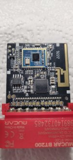

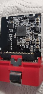

To begin, clean the black plastic from the Mucar BT200 contacts.Hello! Does someone know how to connect this device to st-link ?
how to do that ? The glue is hard, cannot melt itTo begin, clean the black plastic from the Mucar BT200 contacts.

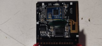

Just did it today.hard glue cannot melt
This is version 1 of the board, with soft glue. Version 2 has hard glue.Just did it today.
I bought regular Коресилин from the hardware store.
Pour ~50ml in some cup and put whole board inside.
Give it 5 minutes. Find something plastic or woden - toothpick, hard toothbrush...
I even used mid soft metal brush for dremel, but only with hand operation, DO NOT use machine for cleaning.
So i made this 8 times: dip for 5mins, take out and scrub carefully!
Be very patient!
ps: things that DO NOT work- IPA, Rust remover, ethyl alcohol, fuel A95, DPF cleaner, Brake cleaner, Carb cleaner, paint remover.

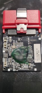

foto ? tc001 is jv700 , gd32f408 with how marking ?new Mucar bt200 2023, new processor
Всем привет , в интернете видел много инструкций, куда подключать stlink , но вскрыл свой адаптер и плата отличается.
Есть у кого свежая инструкция к этой плате ?
Я видел данную информацию, но вид различается , на картинке задняя плата , отличается от моей
