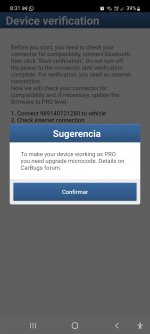

L Luisbarro New member 09.06.2022 #1 Hola me sale eso que puede ser Вложения Screenshot_20220608-203105_Diagzone PRO V2.jpg 347,9 КБ · Просмотры: 23
Q quattro81 Member 09.06.2022 #2 Hola. You need flash it with stlink programmer. Can take manual and flash here Mucar, Thinkdiag mini, Ediag mini, Thinkcar pro, Thinksafe – Google Drive drive.google.com Write me if will have questions
