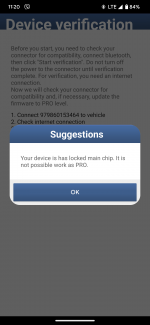

Thank for your support. But i understand why my device can confirm certificate with DZ V1 so it can't workLaunch fw checker cant check is thinkdiag have locked chip or not. It just show fw version. It is unusless
No have solution if your device use new boot from Thinkcar unless you replace main chip for them. But I am not sure about the accuracy of Diagzone. Because I have encountered such a case. But after a while I try to activate it again, it can work again. And if you use V1 for certification, it OK and can buy brand software from Dz. But i am not sure it can use with use V1 for certification with serverHello. I have the same problem, I can't use the app. I get a notification for the chip that it is locked. Does anyone have a solution?
