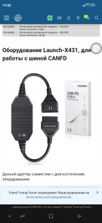

Can FD нужен преобразователь!
    657,8 КБ · Просмотры: 36
Laduck is right! tested with this adapter that appears in the photo that Mihasy posted. Did not work!!
