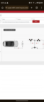

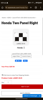

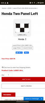

Becaue it needs to be calibrated in static using special targets.. learn some basics about adas calibration first.. and stop clicking buttons without thinking.. now you need somebody with adas equipment to fix your issue..Good day everyone,
Have anyone tried adas ??
I have tried it on honda ens1 EV car
Camera aiming incomplete fault code B2A60_54
Because I couldn't do it
I tired on straight road but took long time without calibration complete
Pease help me guys.
Tanks in advance.
Dear you need to learn more about adas and stop commenting without thinking not all cars requires special target it's not radar it's camera and aiming and can be done without adas tool you just need straight road with signs on the side and this option available and can be done without target tool, I have done many cars using other scan tool.LKAS doesn't need static object open diagzonepro and check this option and requirement .also there is an option were you can just copy all old info from old ecu module to new ecu Incase you have change it without the need to use static target tool .Becaue it needs to be calibrated in static using special targets.. learn some basics about adas calibration first.. and stop clicking buttons without thinking.. now you need somebody with adas equipment to fix your issue..
What do you think is this??Dear you need to learn more about adas and stop commenting without thinking not all cars requires special target it's not radar it's camera and aiming and can be done without adas tool you just need straight road with signs on the side and this option available and can be done without target tool, I have done many cars using other scan tool.LKAS doesn't need static object open diagzonepro and check this option and requirement .also there is an option were you can just copy all old info from old ecu module to new ecu Incase you have change it without the need to use static target tool .
My question if anyone have tried it and worked in diagzonepro.
Thank you, maybe because of glue or thickness of glass. I will check again and I will take screenshot going through all steps.
same steps as in this video also gave me option copy from old ecu to new one.
Anyway I will make screenshot it can be useful for anyone .
